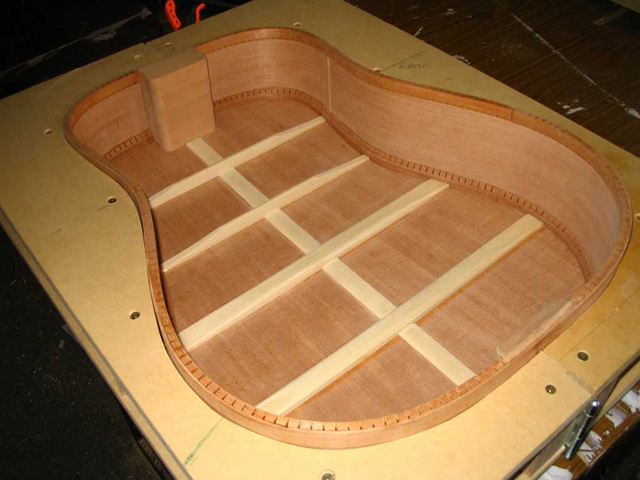

You'll probably see a side re-inforcement at top left. Just a thin piece of mahogany.( there will be more in there eventually. Sides were bent on a Fox-style bender @.085 and we had no problems with bending.
The African Mahog sounds really lively but the dust it produces is quite acrid and bitter. We learnt about this the hard way when re-sawing it and didn't wear masks.

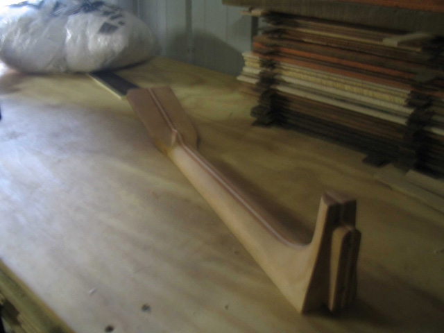

Le Neck (still working on this - and my photography skills)
This is Swietinia from plantations in Fiji. To work with it doesn't appear to any different from the Honduran stuff. Time will only tell !!!
I sincerely hope that it does as there is a reasonable supply here in Melbourne and it could well be an ecologically sound replacement for Honduran Mahogany.
The laminations are Rock Maple and Padauk.

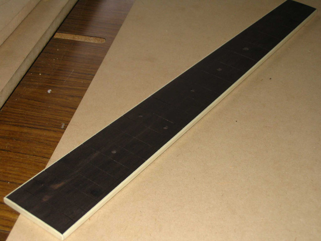

Le Fingerboard (dots went in today)
Ebony with Ivoroid bindings. The body will have Ivoroid as well (avec 'erringbone) (sorry - I've got this French thing going on ce soir)

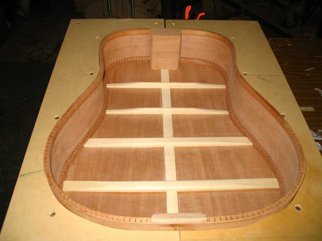

Le Back

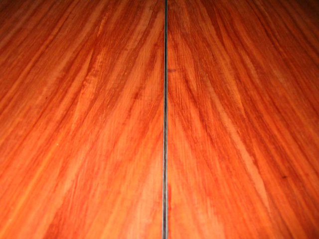

We ran out of things to play with in the shed due to the non-arrival of the Abalone so we started another today which is a Padauk dread.
After reading about everyone's horror stories bending Padauk we are pleased to report that there were no problems. (soaked 'em in water for 10 minutes)

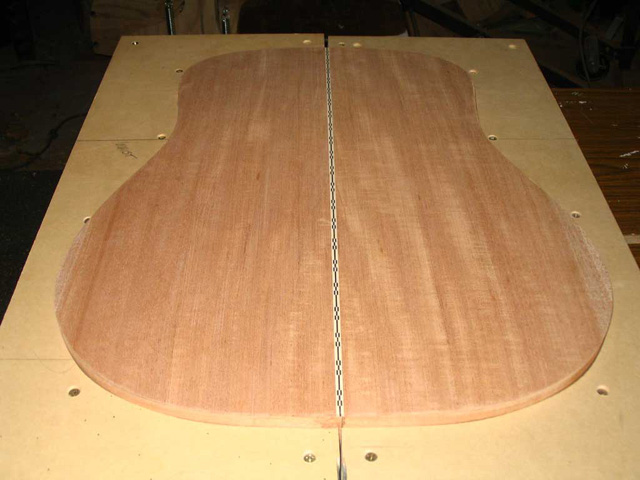

Here's a pic of the back strip - a thin strip of Bombay Blackwood with BWB purfling.

It's looking really impressive so far - really neat. The lower bout back braces look pretty mighty though to me.
The neck is really neat too - the Cuban that I get is also plantation grown (in Micronesia) and is one of the stiffest of the mahoganies and makes great necks.

The boat looks great. Wonderful attention to detail and cleanliness. If it were my guitar, and it isn't to take this any way you wish, I'd be a little concerned with the thickness of the bottom brace, and the next one for that matter. It just looks a bit meaty to my eye which won't hurt anything but add excess weight. I'm from the school of locking down the back and sides and letting the top do all the work. Which is why I say it won't hurt anything to have the oversized bracing.

" le back " looks fairly heavy. What thickness is it ?

Yes I think those two lower braces are a bit beefy now that I inspect them again. I don't think we'll change them on this one for fear of intransigent chisels but the next one I think we'll try the upright style brace as opposed to the flat Martin style one. Anyone have further thoughts on this?
The back is 2.3mm Craig. I think the mark you see in the photo is from the router when we cleaned it up.

Tidy work on the linnings, are those reversed kerfed for the top? What wood is the tail block and heel?

Yes the top linings are reverse kerfed Mahogany.
Tail and neck blocks are both Mahogany.
